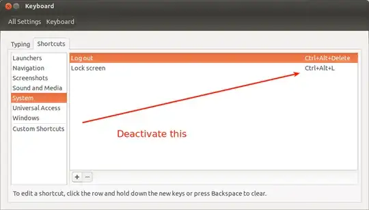

Now what we will do: is just change lock screen command
first step
To disable use Backspace. Than move on to Custom shuortcuts

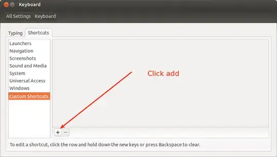

second
Set name something like turn screen off and lock screen and set command to perl ~/.turnScreenOff.pl

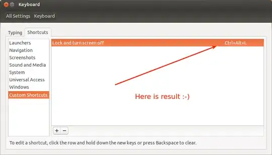

third
And now select that and press buttons you want to set shortcut to, e.g. Ctrl+Alt+L or whatever you want :-)
Hope this helped.
Result!
