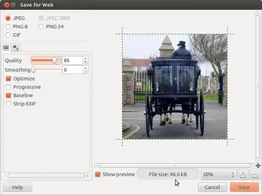

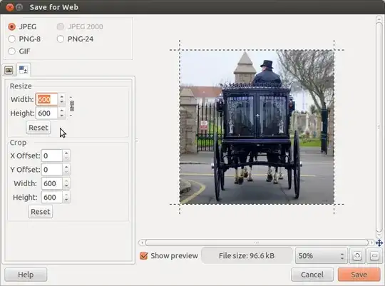

Use Gimp's 'Save for Web' plugin. You can download and install it manually, or just add the gimp-plugin-registry package from the Software Center which includes it (and many more).
Once installed, you just open the image in Gimp, select File -> Save for Web then play with the output settings until you have what you want. There are two tabs on the left. One is for image quality, one is for image size. You can even output the image in a different image format. As you make changes, the output file size (shown below the picture) updates. I use this plugin constantly and highly recommend it.
save for web quality tab
save for web size tab

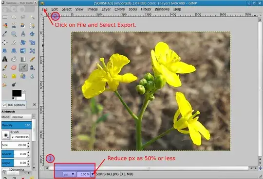

To reduce Image size: Step 1:Right click on the image and open as GIMP image editor.
Step 2:Now Check the footer of the image and reduce the PX percentage (as per requirement) enter image description here
Step 3: Now Click to file and export the image.

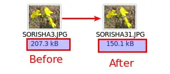

Step 4: Finally check the image size. enter image description here
