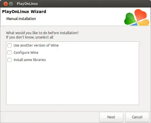

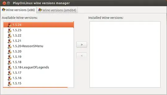

You can use PlayOnLinux to install applications which run on different versions of wine. PlayOnLinux provides an option of installing some libraries as well along with installation of a program.
To mange different versions of wine, go to Tools > Manage Wine Versions
Wine_Versions
If you want to add your custom compiled version of Wine to this list, create new wine "version" in ~/.PlayOnLinux/wine/linux-amd64 or linux-x86 and copy your custom installation there.

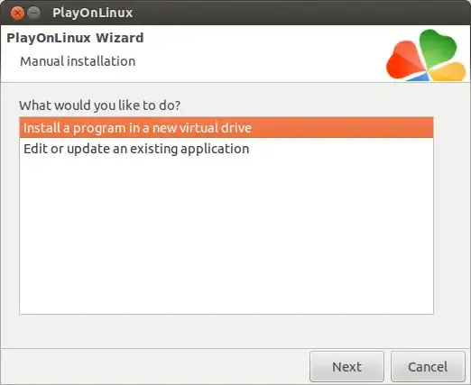

While installing an application you have an option of installing it a new virtual drive, in which you can install a different version of wine.
