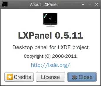

The problem is with the way the version of a build (especially dev version) is displayed.
In Lubuntu Quantal, the LXPanel version that works with only libmenu-cache1 is displayed as
But in Synaptic Manager it's 0.5.10:
Also,

Also, after installing (in Lubuntu Precise) LXPanel for Precise from here, which looks like being a daily build of 0.5.11 (Launchpad named it lxpanel-dev-0.5.11~bzr1306+201301150740~precise1) (which was possible only after installing libmenu-cache2 for Raring from here) I see that LXPanel "About" says version 0.5.12, while in Synaptic it was displayed 0.5.11.
So, the dev version installed in Precise is not the same version as the one from the other computer running Quantal, but a newer build that asks for libmenu-cache2, while that quantal version does not.
It seems that LXPanel versions above 0.5.10 need libmenu-cache2.
(But to see the real version of a build one must look in Synaptic or run apt-cache policy lxpanel, because dev builds might show a newer version in "About" section.)
