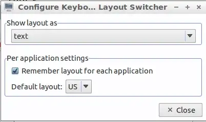

12.04 "Keyboard Layout Switcher" settings:

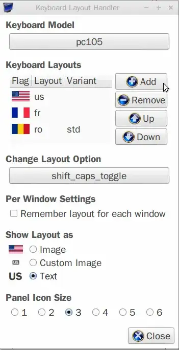

12.10 "Keyboard Layout Handler" settings:

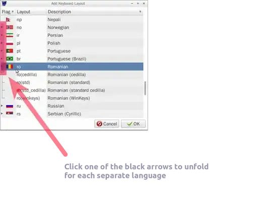

which include adding new keyboard

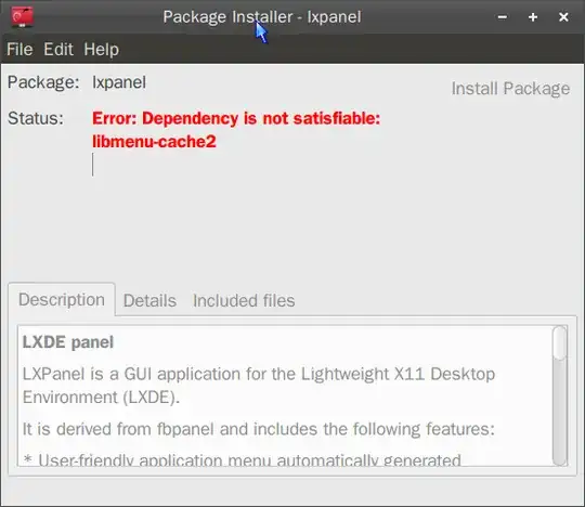

The 0.5.11 version of LXPanel is available for Precise as deb here - but gives this error while trying to install with gdebi: enter image description here
But libmenu-cache2 appears available only for Raring 13.04. Installing that in Precise and then the latest LXPanel is possible but it may be safer to stay with LXPanel 0.5.10 in Precise until update from official sources. About that dependency see this question.)
