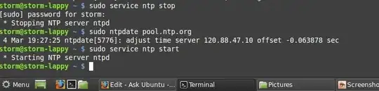

If you get the Error NTP socket in use as shown below:
In that case just run
$ sudo service ntp stop
$ sudo ntpdate pool.ntp.org
$ sudo service ntp start
and you will get
