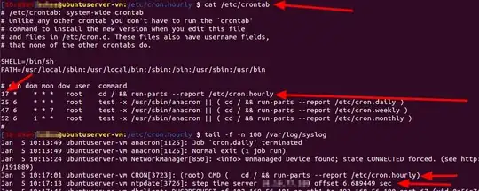

Every hour ntpdate will sync to server of your choice. (Default cron.hourly time on mine is processed ~17 minutes after the hour) ..in addition to the system default sync done when interface comes up (usually when system comes up after a reboot).
I personally run the ntpd server on my main Ubuntu server (stays sync'd from accurate ntp server pools on Internet) - which in turn feeds all of my LAN machines via ntpdate as per above - as the client. This way my LAN is synchronized from one local point using Ubuntu's default ntpdate utility.
Syslog at 17 minutes past hour..
