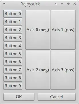

b) Rejoystick
If you have problems with joy2key, rejoystick would probably be better, as it has a gui (see screenshot) that you use to setup your joypad (see screenshot). You can install the deb from sourceforge. You connect your joypad, launch the settings gui by entering rejoystick in terminal, and then you enter your settings and click ok to save the profile to ~/.rejoystickrc. Then you just run rejoystick -d before you launch your game; enter killall -s SIGKILL rejoystick to clear the current bindings in effect. It does seem to work, but I'm not sure if you can have different profiles like you can with qjoypad.
In short, I highly recommend trying the solutions given further above to solve the compiling problems with qjoypad, as joy2key can be a pain to get set up correctly, although rejoystick is much simpler and may be useful.
