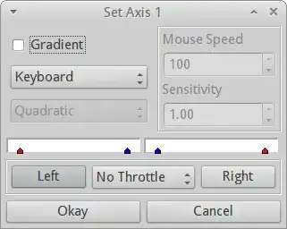

  1. Click add to create a new profile and name it, and then you can assign all the buttons available, but you must click update to save your settings.
    screenshot
  2. You can fully configure all the axis points, and both sidewinder type and dual analog devices seem to be configurable. More details on this are available in this article and on the useful readme included with the source code download.
    screenshot

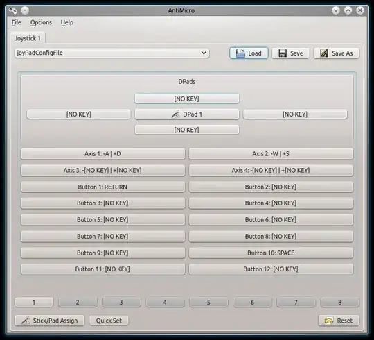

Try atimicro app which for me was the best!
https://github.com/AntiMicro/antimicro
