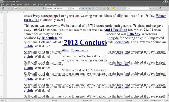

Example. Have pasted a text here

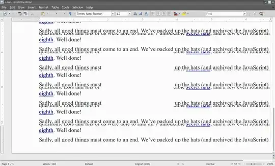

After scrolling down:
and down:

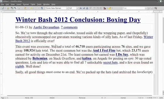

and then up:
Clicking on the text restores it but it always goes back to the beginning which is the only part that is visible in this way - and larger documents are almost unusable!
The document can be taken under control if the zoom is equal or lower than 180%. It may vary depending on display and resolution, but it seems to me that the problem disappears as soon as the zoom goes down so that the page is largely within the margins of the maximized window.
On my display the comfortable zoom level (the one that I would prefer to use, and cannot) would be 230% (e. g. with 11 Arial).
