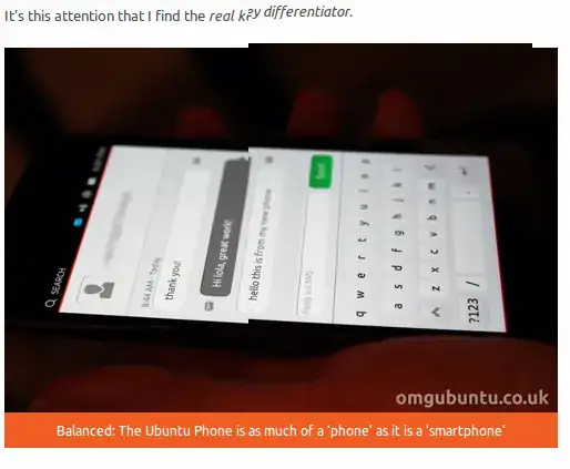

Simply put, I have rendering problems on Chrome on pages what seem to use latest fancy flash and other eye-candy (youtube.com among them) stuff. I am experiencing vertical tearing.
Some examples:
text tearing image tearing

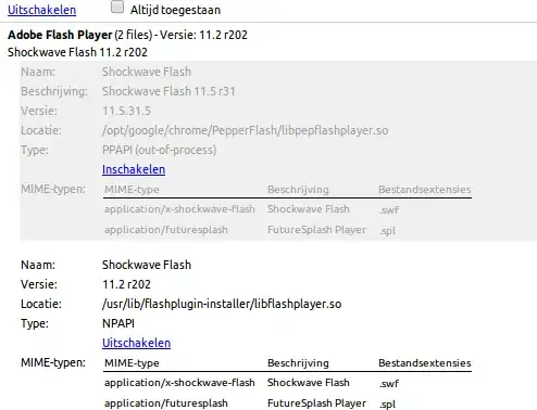

Going to chrome://plugins/ at the flash-player section I have to following:

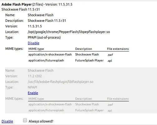

I have the same problems, seems that the new Pepper Flash version included by default with Chrome doesn't play well with AMD cards. I haven't found a good way to solve it yet, but a workaround is to just use the normal flash player included by Ubuntu instead.
To do that, go to chrome://plugins
  • On the right side of the screen, click on "Details" if neccasery.
  • Search for the Adobe Flash Player plugin and disable the PPAPI (pepper) plugin, leaving the other one enabled.
  • Restart the browser to apply the changes.
EDIT: Screenshot of what I meanScreenshot of Flash settings
