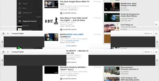

I am facing some serious web page rendering issues with Chrome. It is more prominent during javascript based animations and stuff on websites like youtube. I have tried removing chrome using (sudo apt-get purge google-chrome-stable) and then reinstalling it. But the problems still persist. The same webpages work correctly on firefox on ubuntu and chrome on windows. The problem only shows up when I use chrome on ubuntu.
I think the issue has started after I updated to the latest version of Chrome. I have used Chrome previously on this machine without any problems.
I have attached a image that demonstrates the issue.
What could possibly be the problem?

The issue was with the graphic drivers.
I downloaded and installed the latest driver from AMD and now everything looks fine.
Thanks to @tijybba.

I resolved the problem by enabling the "tear free" option on the Catalyst Control Center:
System Tools → Preferences → AMD Catalyst Control Center → Display Options → Tear Free
