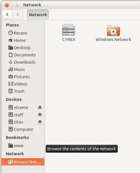

After this, to access any other computers on the Network you can open the File Browser and select Browse Network :
