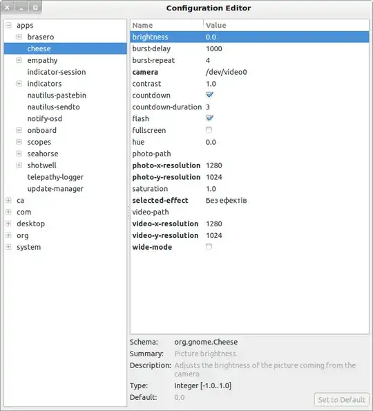

Ubuntu Cheese dconf-editor screenshot
You could easily play with the settings (they all typically have well-documented schemata displayed in the bottom of the dconf-editor window), and, ultimately, wipe the settings clean by resetting the values to defaults (non-defaults are highlighted with bold font as you can see on my screenshot).
Besides dconf-editor, you can also do this from the command line:
gsettings reset-recursively org.gnome.Cheese:/apps/cheese
