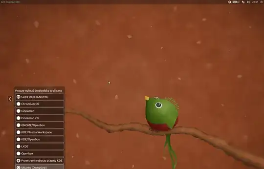

Today I tried to play with LXDE. After installing I go to login screen and try to select LXDE from list of avaible DE, but I can't select OK after that. screenshot. I know this is bug, but maybe somebody can help me with finding temporary solution.

As a workaround you can switch to lxdm, it includes a drop-down list that scrolls.
sudo dpkg-reconfigure lightdm
and select lxdm or another login manager like gdm
Restart the computer and you should be greeted with a different login manager.
If you really need to login to a different desktop, with lightdm in its current state (say the current selected one is unusable) you can use the tab key to cycle through the list, counting once the selection is off the screen until it cycles back to the top. You then know how many tabs it takes to get to the "OK" button, and can hit enter to select it.
Also it seems that the bug you linked is a duplicate of this bug, Launchpad Bug 1068605 be sure to click on the "This bug affects me"
And if there are some desktops you don't use: maybe a "2d" version of one desktop, or the openbox version of another... you can remove some from the list by following this question,
How to remove session entries from LightDM?
Or you may be able to change the LightDM greeter, How to change the LightDM theme/greeter?
Hopefully, that will give you some options to workaround the bug until it is fixed in future versions.
