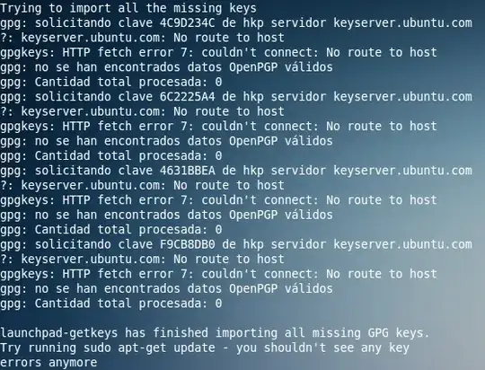

I've a problem at the office. We're behind a proxy (which is set and applied at ubuntu proxy settings) and when I try to add a repository from terminal, I get:
Error reading --some url here--: urlopen error [Errno 113] No route to host
I've tried with
  • Launchpad-getkeys script. I get this (image)
  • I've tried with another "hack", without luck
    1. Press Alt-F2 and type gksu gedit /usr/lib/python2.6/dist-packages/softwareproperties/ppa.py
    2. Find line 88, change keyserver.ubuntu.com to hkp://keyserver.ubuntu.com:80
    3. Save, close and reboot.
Does anyone know if I could solve this problem in any way? Thanks
