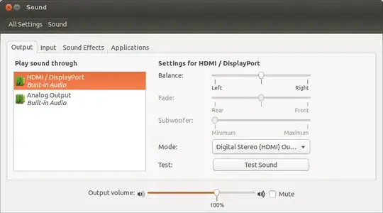

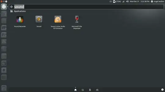

I had the same problem, mine's was result by opening the dash and write it down: sound, open it and in output tab, appear HDDMI / Display Port I select it and wuala it works for me. My computer is a Asus k52f.
Click on Sound
THEN... it appears
Click on HDDMI / Display Port and the tv sound should work fine, I saw The dark night rises yesterday using HDMI port!

For the sound, in sound settings you need to change the sound output from analog to HDMI Audio.
In windows, the option only pops up after you've connected via HDMI -- but in Ubuntu you can do so any time you wish, you just won't hear anything if you aren't connected to an alternate sound source through HDMI.
