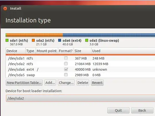

  2. Boot with ubuntu, created two partition. One for SWAP and one for /. Most important, choose the GRUB location same as the / partition. See pic below (I think I took wrong screenshot, bootloader location should be sda6 in picture),
    ubuntu from windows 8 loader

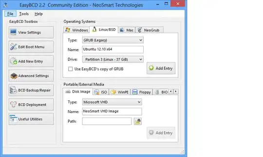

  3. Now after installation, open up EasyBCD. Goto Add new menu entry, select Linux tab, choose GRUB2 from dropdown and the disk name where we put the GRUb in step 2. Click on Add Entry

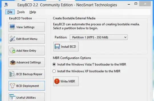

  4. Goto BCD deployment, and write MBR ubuntu from windows 8 loader

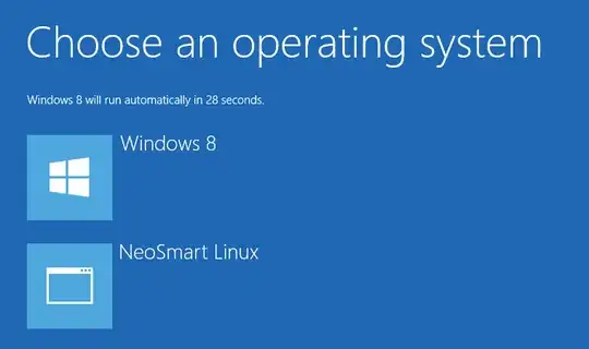

  5. Now boot and you should get the screen. I restarted several times, every time I got the GUI boot screen. And ubuntu works also.(I forget to change the name step3) ubuntu from windows 8 loader
