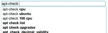

It seems that I'm not the only one running into trouble here. All suggestions for apt-check are pretty negative:
(clean browser, not logged in, no personalised search)
