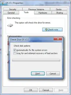

What you need to do is to run chkdsk /f (or /r) from Windows on the drive you installed Wubi. If you installed on the C:\ drive this will require a full restart.
To run chkdsk on Windows 7 (the first checkbox corresponds to chkdsk /f and the second to chkdsk /r:
chkdsk on Windows7
If prompted, restart the computer and boot into Windows to complete the chkdsk making sure not to 'Hit a key' to abort it.
