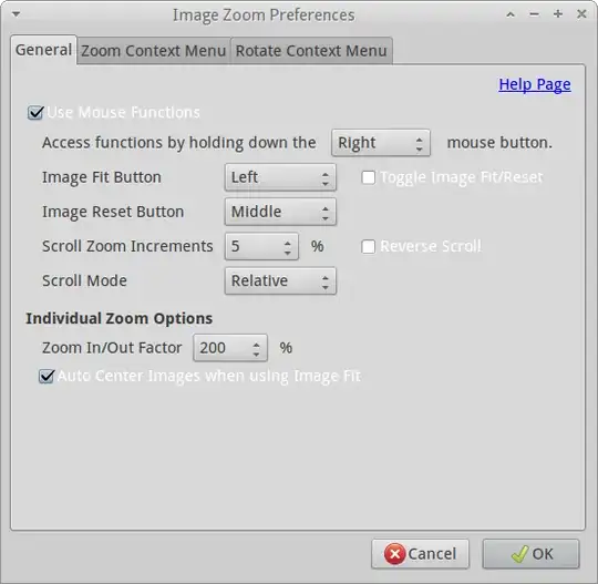

    As you can see in the screenshot below, there are settings for the scroll zoom when you go to firefox > addons > image zoom > preferences. Scrolling using both the middle mouse wheel or the two fingers mode on the touchpad works as well.
    As noted in the description for the addon, you can use it to:
    easily zoom in, zoom out, fit image to screen or set custom zoom on individual images...All this can be done by using the context menu or a combination of mouse buttons and scroll wheel.
    Just open the image in firefox, zoom it up and then you are able to scroll it; it is about the best way of achieving what you want at the minute and I use it regularly.
