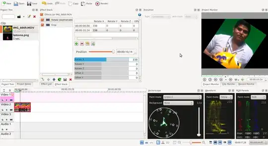

kdenlive "Rotate (keyframable)" and "Rotate and shear" Plugins can do what you wish BUT you will be in the need to render a different file which can be made using the same dimensions and codec of the original.
In the next screenshot I am using an iPhone 4S ".mov" video file in order to rotate and crop it in a rectangular 4:3 video project. After which I can run a render to create a new source. The changes will be observed by the majority of the operating systems and their respective video players.
