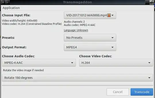

A simple tool that can also rotate is transmageddon. Install it with
sudo apt install transmageddon
then load your file into it and choose the rotation position
ptetteh227
