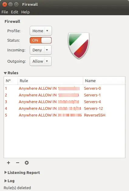

Here, I'm allowing all traffic from specific server VLANs in my corporate environment and I've added a rule to allow the necessary ports for a reverse SSH session to bounce off this machine.
GUFW Screenshot
