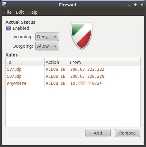

First, I'd un-install Firestarter completely. I don't believe that it's still under development any longer (might be wrong), but regardless, it's been superceded by the "official" Uncomplicated Firewall (ufw) which has a nice UI already. So :
sudo apt-get remove firestarter
Then install gufw :
sudo apt-get install gufw
Then reset your IPTables (which is what UFW is based on) :
sudo ufw reset
(you can also do this using gufw, in the Edit menu)
And then finally manage your firewall using that tool. Start GUFW from System/Administration/Firewall Configuration.
GUFW Interface
