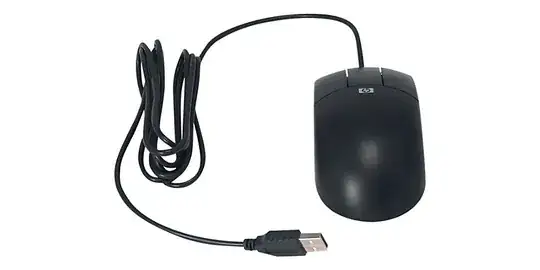

Indeed, I pasted that block quote with my ancient and still functioning PS/2 three-button mouse (no scroll-wheel ; a real three-button mouse).
I recently ordered a new-fangled yet old-school 3-button mouse. This one is optical and has a usb connector. Wow. It was about $20 USD, and available from many online vendors.
Behold, the HP DY651A :
picture of 3-button mouse, circa 2014
I'd say buy one now, so you can enjoy an authentic X-Windows *nix experience before it disappears.
