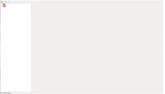

To open an image file click on the 'plus' (+) sign.

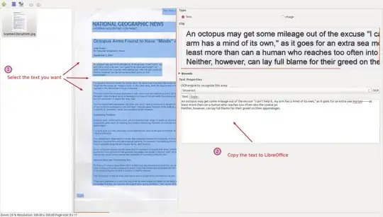

enter image description here After you have opened the image, click on the next icon to the right to run OCR.
After is has finished OCR'ing the image, you can select the text you want on the left, and copy it out on the right.

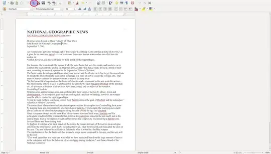

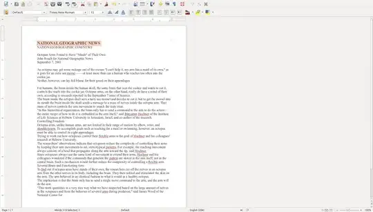

The easiest way to get the text out is to just copy it over to LibreOffice. With a little editing, my copy looks very similar.
After you make the required changes you can export them as .pdf by clicking 'export as pdf' from the LibreOffice toobar. enter image description here

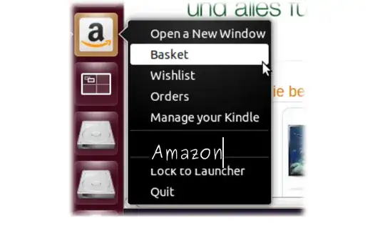

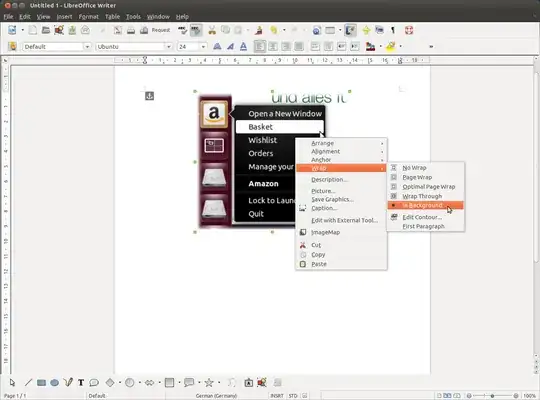

We can also edit text on top of an image with Libre Office from where we can also easily export this files as PDF.
  • Open your document to insert the image with Insert -> Picture -> From File....
  • Then choose "Wrap -> In Background" from the right click context menu on the picture you just inserted.
  • Write any text above the image (but we will have to place it with newlines, and spaces or tabstops). Any preexisting text needs to be overwritten. In the example below I have done this by choosing a black background and a white font colour.
  • Finally we can do "File -> Export as PDF...".
