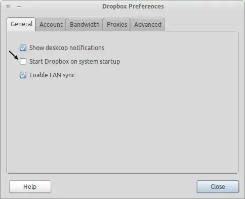

First, disable Dropbox from starting on login.
Open up the DropBox preferences and uncheck Start Dropbox on system startup:

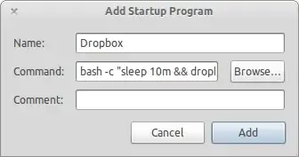

Now we will manually add Dropbox to the list of applications that run on login.
Open up System ➜ Preferences ➜ Startup Applications and click on Add to add a new entry.
Use Dropbox for the name and bash -c "sleep 10m && dropbox start -i" for the command, and then click Add to save it.
That's it, now Dropbox won't start until 10 minutes after you have logged in.
