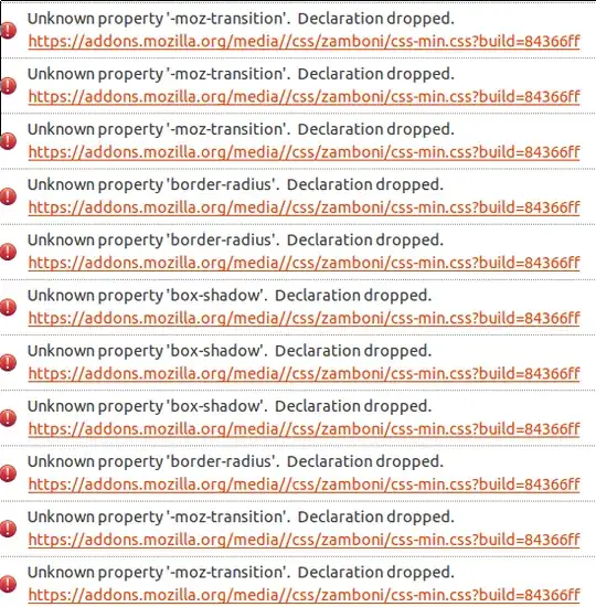

I´ĺl post the Firefox console error here:
alt text
