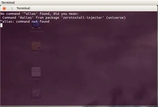

I followed this guide in omg ubuntu.
I've just replaced the "GalaxyNexus" with "AsusInfinity".
Now terminal won't open printing this:
And closing after that...
What did the last 3 commands do (before android-connect)?
What can I do to fix this?

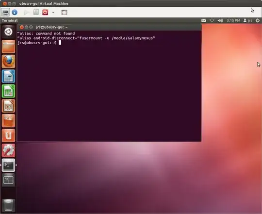

The problem is that you copied and pasted lines from a blog that contained "pretty" (typographic) quotes into your .bashrc file, so instead of running the command alias, your .bashrc is trying (and failing) to run "alias.

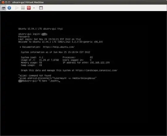

I'm not entirely sure I recreated your problem 100%; when I did the same thing in a virtual machine, I did get the same alias command error that you did, but my Terminal window doesn't auto-close.
Still, I think I know what you'll need to do in order to fix it, even though I can't 100% recreate the problem on my end. Please press CtrlAltF1 in order to get to a text-only console. Now log in as your normal username and password.

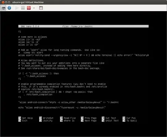

From here, nano ~/.bashrc, and you will load up your .bashrc file in a simple text mode editor.
Delete those last few lines that you added; you should recognize them pretty easily. Ctrlk is the keyboard shortcut to delete a whole line (as you can see in the bottom lines of text in nano). Once you've deleted them, press Ctrlx to exit, and be sure to say yes when it asks you if you want to save your changes.
Once you're back at the prompt, type in exit, then press CtrlAltF7 to get back to your graphical session. You should now be able to open the Terminal without it auto-closing on you.
