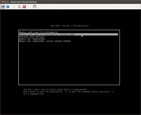

If you could not change your password, let's get into Recovery Mode. Reboot the system, and at the GNU GRUB menu, press down arrow, and select (recovery mode) as shown here:
Grub Menu

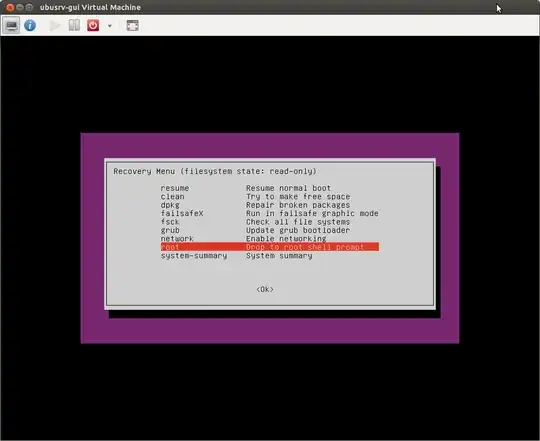

Now, drop to root shell prompt:
