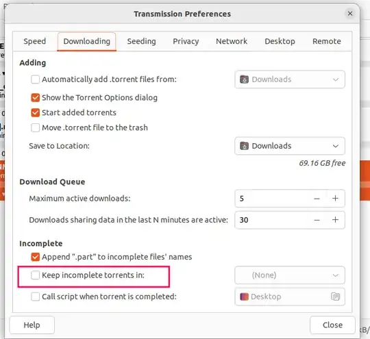

Try to disable this setting, so no temprorary files should be save & cause permissions issue:
