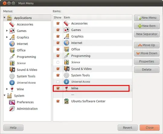

First go to System → Preferences → Main Menu and make you sure there is item Wine and is't checked.
If there's no Wine entry, open Nautilus (ubuntu default file browser), press Crl+H to show hidden files/folders, goto .config/menus and delete here file application.menu -- Gnome will automatically recreate this file with default application menu configuration.
