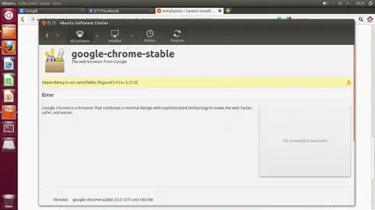

I can't install Google Chrome browser. I wonder why and how to fix it. Here is the log I got from my terminal when installing Google Chrome.

It does not work in GUI too. Look at what I have got:
on GUI

You can fix this by installing missing dependencies.
Just run the following command
(after you have run sudo dpkg -i google-chrome-stable_current_i386.deb).
sudo apt-get install -f
This will install missing dependencies and configure Google Chrome for you.

You probably need to enable the "universe" repository.
Once you enable it, update your system and you should now be able to install google-chrome-stable.
sudo apt-get update
sudo apt-get install libgconf2-4 libnss3-1d libxss1
