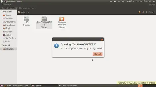

I want to setup a home network that grants full access to and from all machines in my home. All 4 of my machines are running Ubuntu 12.04. I tried setting up filesharing but have 2 problems with this: First, it does not grant me the complete access I desire and I have to share individual directories one by one. Secondly, after following the instructions here for quick file sharing setup: How do I set up file sharing between two Ubuntu laptops on my wireless network? under "browse network" all machines show up, but when I try to to open them, I see this: opening Followed by this a few seconds later: enter image description here
I would appreciate any assistance I can get on his issue! Thanks!

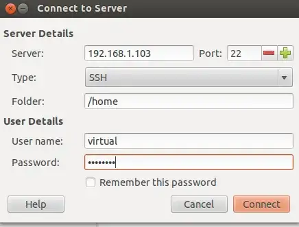

You can share between two ubuntu's computers through ssh.
Let's say you want to share the /home folder of your server.
Install ssh by this command in your server.
sudo apt-get install ssh
run ifconfig command and write down your ip address eg: 192.168.1.103
test you can loggin in by ssh to the server in the client machine.
ssh user@192.168.1.103
In the client machine with Ubuntu Desktop go to file > connect to server
then you can complete all fields with your info
This will be open a nautilus with the folder /home in the server like this. enter image description here
In nautilus under the laber Network you will see the server
You can right click on it and select "Add Bookmark" So you can connect to the ser with one click.
