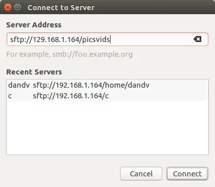

On the client, open Nautilus (Super+E) and go to “File -> Connect to Server”.
Enter sftp://<the_IP_of_the_server>
Ubuntu 16 Connect to Server dialog
On older version of Ubuntu, you could pick the folder you wish to share. As of Ubuntu 16, if you don't specify a path after the IP, you'll get the home directory. For a specific directory outside of the home dir of the user you're connecting as, you need to type its path.

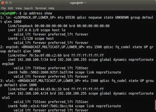

Get your local ip address of system which has files you want to access
ip address show
if connected to wifi pick 3: wl01 or in case of Ethernet pick 2: enp3s0
