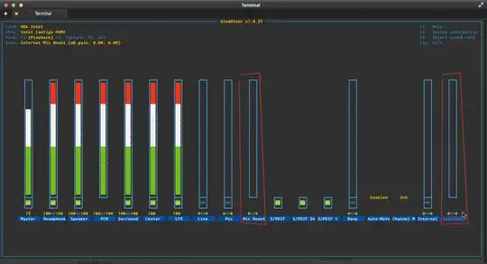

The most probable cause of constant noise coming in from the speakers is usually mic boost. In order to disable this:
  1. Open a terminal.
  2. Type alsamixer and press Enter.
  3. Reduce the Mic Boost and Internal Mic Boost to zero. Refer to screenshot.
Screenshot

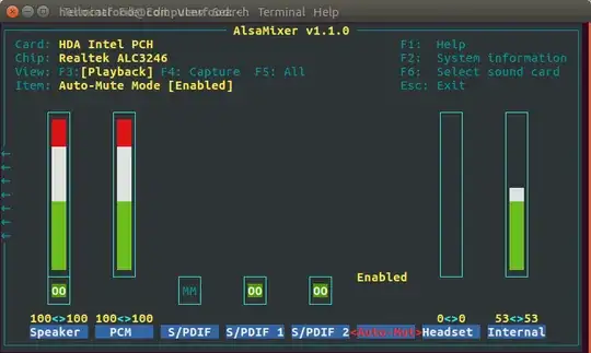

The problem goes away after disabling the Auto-Mute mode. Run alsamixer in the terminal, scroll to the right and press up/down to enable or disable Auto-Mute mode
