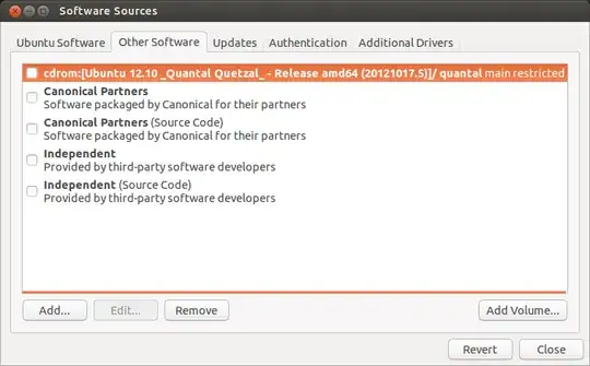

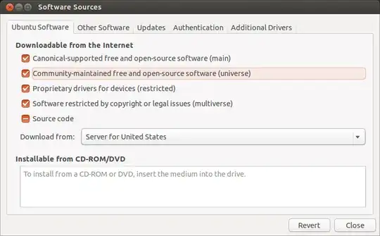

GUI-based repository management is normally accomplished via "Software Sources". This interface can be accessed via several methods. For the latest versions of Ubuntu, the easiest way is to go through the "Ubuntu Software Center". Open the software center, then from the Edit menu select "Software Sources". You will have to enter your password to change settings in this window.

Select the "Other Software" tab and uncheck the offending repository. This will disable the repository (You can re-enable it this way too).
