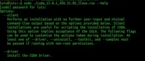

For cases where you use the CUDA installer, in the documentation for it you can find more options on how to uninstall it, like this excerpt:
To uninstall the CUDA Toolkit, run the uninstallation script provided in the bin directory of the toolkit. By default, it is located in /usr/local/cuda-11.0/bin:
sudo /usr/local/cuda-11.0/bin/cuda-uninstaller
To uninstall the NVIDIA Driver, run nvidia-uninstall:
sudo /usr/bin/nvidia-uninstall
And others that can be seen when you run the --help parameter
