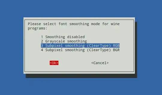

  • The most important improvement concerning fonts is to enable font smoothing - save script below as winefontssmoothing_en.sh and run in Terminal using command bash winefontssmoothing_en.sh:

select third option in terminal - with the arrows, then use tab key to select ok and 'enter'
winefontssmoothing_en.sh dialog
(source here)

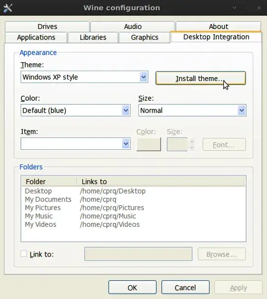

  • For a better system appearance install a windows msstyle file in winecfg (Wine/Configure Wine/Desktop Integration) like "Luna", or "Royale".

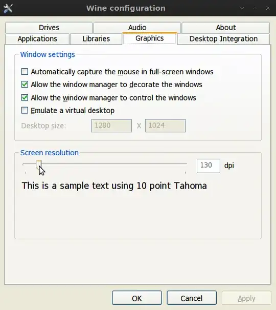

  • Increase the screen resolution in winecfg (Wine/Configure Wine/Graphics), which will make general details (including fonts) larger (if that's what you need: on my laptop appearance details of wine programs are too small by default)

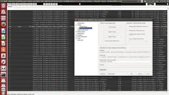

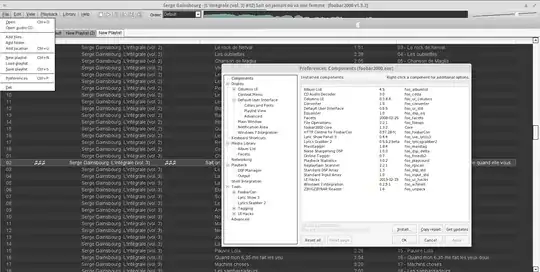

But the images above are taken after enabling font smoothing. That is the most important action, as I was able to test. As I had to reinstall Wine at some point, I also had to restart all procedures here. Using all the other solutions (including installing all fonts as suggested in Shauna's answer - which is very advisable, and to be considered as a part of the solution to this question) -- with the exception of font smoothing, Foobar2000 looked like so:
After font smoothing:
Important: Changing settings in winecfg may reset font smoothing, so it is better to run that in the end, or re-enable it when fonts seem ugly.

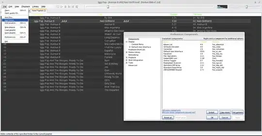

(mentioned by this more recent answer), the results may vary depending on the Linux desktop and the different applications. The GTK theming in Wine seems a matter of preference as it is debatable whether a GTK theme on a Windows program looks better than a Windows-theming.
Example for Foobar2000:
In Ubuntu:
In elementaryOS:
Not much improvement compared to msstyle Luna by default in Playonlinux:
