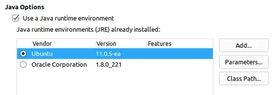

(I know this is an old question but happened to me again now)
For me, changing the Java Runtime fixed the problem, instead of using the Oracle one I choose the Ubuntu and the bar appears again.
Choosing Ubuntu runtime instead of Oracle
