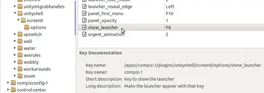

I just installed Ubuntu 11.04 and I was able to use gconf-editor to change the shortcut key.
Make sure you're not running gnome-do! (If it's set to use your key combo, the Dash won't be able to bind to those keys.)
Open a terminal and run gconf-editor
Navigate to this key:
/apps/compiz-1/plugins/unityshell/screen0/options/show_launcher
Modify the show_launcher key to a single key value.
The key in gconf-editor
I set the value to <Super>space and now Super+space opens the dash instead of Super. Note that if you use a key combo, it seems to take a minute before you can use that to invoke the Dash. You also need to complete the key combo quickly.
