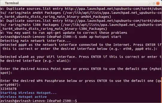

Some mobile devices doesn't able to detect the hotspot created on ubuntu by default method.
Solution for this problem is to install ap-hotspot software on Ubuntu.
For Ubuntu 12.10,13.04,13.10
Run these commands to install ap-hotspot.
sudo add-apt-repository ppa:nilarimogard/webupd8
sudo apt-get update
sudo apt-get install ap-hotspot
Run these commands to start and stop ap-hotspot.
sudo ap-hotspot start
sudo ap-hotspot stop
Run this command to configure ap-hotspot
sudo ap-hotspot configure
If it asks for WPA passphrase give a key with the minimum of 8 characters.
OR
For Ubuntu 12.04
you can download the script from here.This script requires Hostapd 1.0 which was available by default in Ubuntu 12.10,13.04,13.10.
For Ubuntu 12.04,add these two lines to /etc/apt/sources.list
deb http://ppa.launchpad.net/network-manager/ppa/ubuntu precise main
deb-src http://ppa.launchpad.net/network-manager/ppa/ubuntu precise main
and save the file and run the below commands in terminal.
sudo apt-get update
sudo apt-get install hostapd
