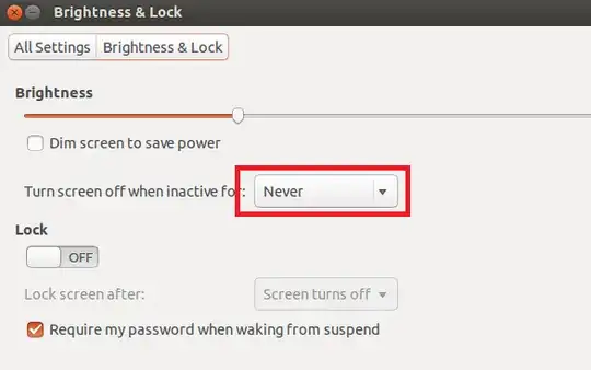

After a fresh install of Ubuntu 12.10, my screen still goes off after about ten minutes. I've been to the Brightness and Lock control panel. The Turn screen off when inactive for: setting is set to Never.

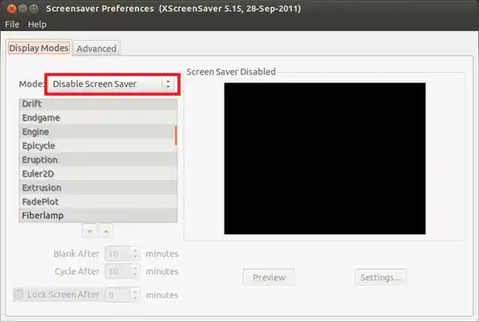

3. layer: Last but not least; the application layer (XScreenSaver)
xscreensaver-demo
Choose Disable Screen Saver:
xscreensaver
And deactivate screensaver in System Settings -> Brightness & Lock (depends on your desktop environment):
Turn screen of when inactive for: Never

There is a checkbox in "System Settings" -> "Brightness And Lock" screen whose label is "Dim screen to save power". You must uncheck it.

  1. Click System Settings.
  2. In the "Hardware" tab choose "Power"
  3. Click the link: "Brightness settings"
  4. There is a dropdown called: "Turn screen off when inactive for"
Set the dropdown to 'Never'.
