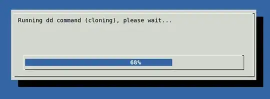

And my favorite for cloning a disk drive (replace X with drive letters):
(pv -n /dev/sdX | dd of=/dev/sdX bs=128M conv=notrunc,noerror) 2>&1 | dialog --gauge "Running dd command (cloning), please wait..." 10 70 0
screenshot
source: http://www.cyberciti.biz/faq/linux-unix-dd-command-show-progress-while-coping/
Also for archiving myself.

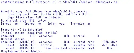

I really like ddrescue, it works as dd but gives output and doesn't fail on errors, on the contrary it has a very advanced algorithm an tries really hard to do a successful copy... There are also many GUIs for it
Project: https://www.gnu.org/software/ddrescue
Wikipedia: https://en.wikipedia.org/wiki/Ddrescue

To add on @JSBack great answer, here is how you can get a dialog to wipe a disk with dd:
(dd if=/dev/zero | pv -s $(lsblk -b -o SIZE /dev/sdX | tail -n 1) -n | sudo dd of=/dev/sdX bs=1M) 2>&1  | dialog --gauge "Wiping disk /dev/sdX, Please wait..." 10 70 0
