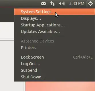

After saving the file you have to restart the X server. As Ctrl+Alt+Backspace didn't work on my system I restarted the system and was now able to select the new layout in System Settings... -> Keyboard Layout.

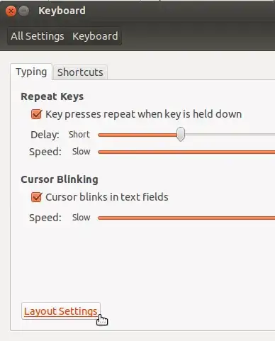

  1. Go to System Settings > Keyboard
  2. Click on Layout Settings (button at bottom)

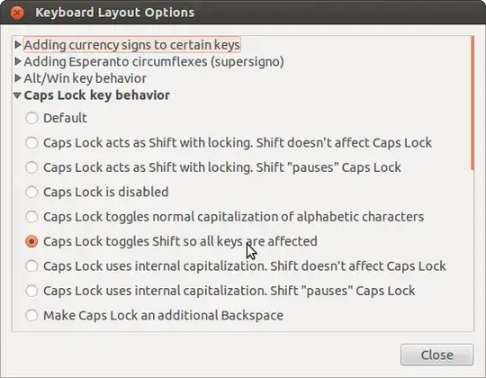

  1. Select your layout in my case English (US) > Click Options
  2. Hit the arrow on "Caps Lock Key behavior" > Then select "Caps Lock toggles Shift so all keys are affected"
Or, under "Miscellaneous compatibility options" you can check "Both Shift-Keys together toggle ShiftLock" if you want to keep the Caps Lock functioning the same, then you can press both Shift keys.
