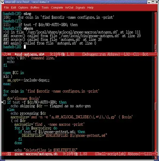

Yes, there is Bash Debugger Project.
You can also use set -x and set -v at execution. More info:
http://www.linuxtopia.org/online_books/advanced_bash_scripting_guide/debugging.html http://www.cyberciti.biz/tips/debugging-shell-script.html

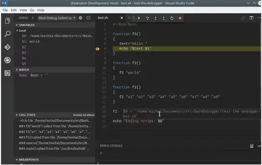

Nowadays, there is the Visual Studio Code Bash Debug extension. It has 'Step in/out/over' and can show the value of each variable.
VS Code Bash Debug screenshot

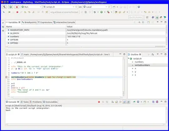

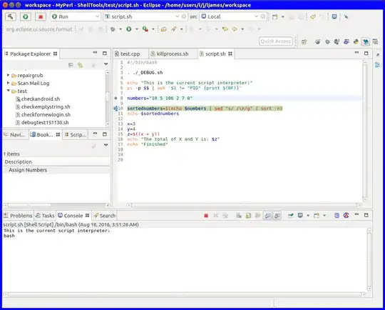

A GUI option for debugging a bash script is the Eclipse IDE with the BashEclipse/Shelled pluggins.
This gives the features of your question (breakpoints and stuff) along with a host of other features for debugging complex bash scripts.
Some of the features include:
(https://unix.stackexchange.com/questions/155551/how-to-debug-a-bash-script)
  • Break Point toggle
  • Single Step-by-step operation
  • Step-in, Step-out, Step-over functions and sub-routines
  • Examining code variables at any point while script is running
  • TODO task list
  • Bookmark list
  • Multiple Window Editing
  • Remote Sharing of the project environment
The Script Editor perspective: Eclipse Script IDE
The Debugging perspective: Eclipse Script Debug Perspective
The steps for using is to add the Shelled and BashEclipse pluggins to eclipse. Then run the procedure provided in the BashEclipse read me text file to start the debugger.
