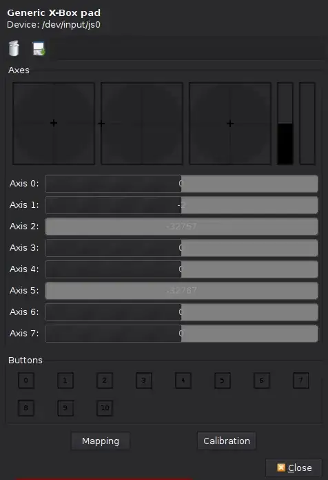

Unfortunately, m64py was not a working solution for me and "trial and error" is too cumbersome. Here is a solution anybody currently running mupen64plus, with or without a gui, should be able to use.
You will need the joystick calibration tool jscal to determine which button is which. For help with that, see Ubuntu Forums - Gaming & Leisure - HOWTO : Joystick/Gamepads under Ubuntu
Assuming you have that set up and your joystick is already calibrated properly, all you need to do is run jstest-gtk /dev/input/js0 &, where js0 is the calibration file for the device you are currently testing.
You will see a gui for numbered axes and buttons. It looks something like this:
jscal controller and joystick button mapping for mupen linux
Now you can press a button on your controller to see which axis or button it corresponds with.

Using jstest, you should be able to figure out how you want to configure InputAutoCfg.ini to customize your input settings using the input event words.
