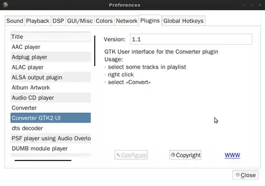

I t looks like Deadbeef player should convert between different audio formats just by right-clicking and selecting "Convert"
But after that and a few seconds of delay as if working nothing happens.
Has anybody used it successfully and how?

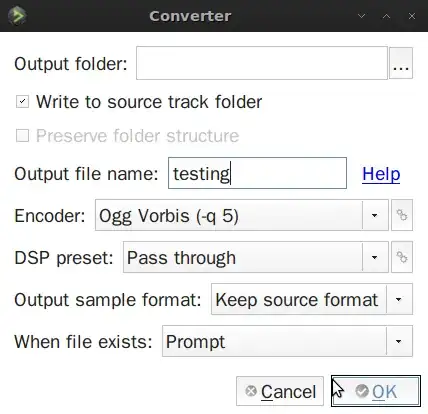

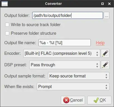

To get the proper file names and to set output location:
%a - %t [%l] will produce something like Artist - Title [1:23]. More on title formatting, here.
