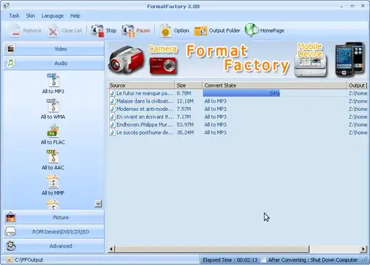

In this case I had to use a piece of heavy artillery I was familiar with in Windows: Format Factory (for a clean download use the torrent)

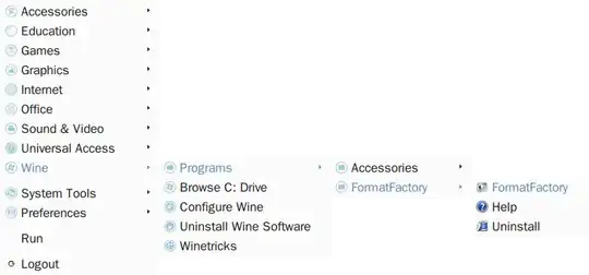

Unzip if needed and install Format Factory ... after installing Wine, of course.

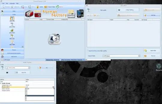

A lot of settings are possible
